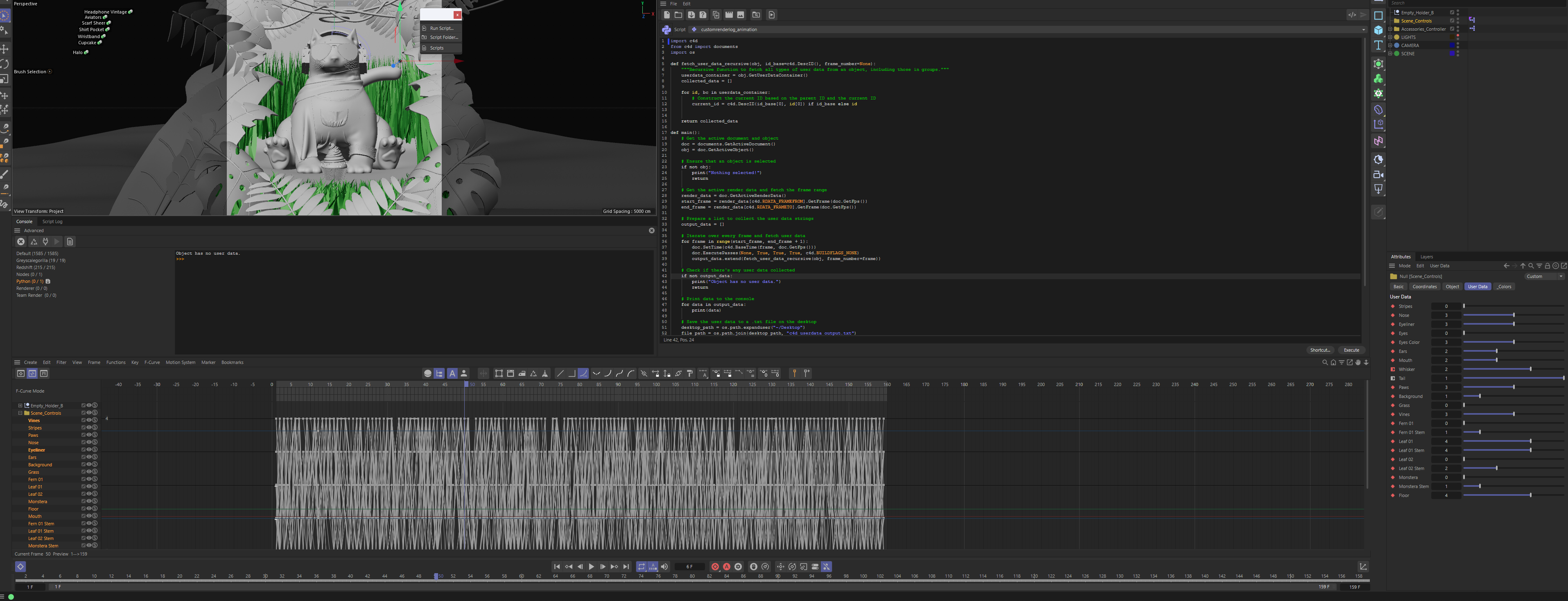

      I am trying to write a python script that dumps all the custom user data of a given object per frame in the timeline and outputs that data to text file. right now if any data is in a "Group" it refuses to work, the script cant see the custom user data. Python not being my main coding library I'm not sure what I'm missing. its not actually failing so there are no breakpoints to check from my understanding. any help would be really cool.
      from c4d import documents
      import os
      def fetch_user_data_recursive(obj, id_base=c4d.DescID(), frame_number=None):
          """Recursive function to fetch all types of user data from an object, including those in groups."""
          userdata_container = obj.GetUserDataContainer()
          collected_data = []
          for id, bc in userdata_container:
              # Construct the current ID based on the parent ID and the current ID
              current_id = c4d.DescID(id_base[0], id[0]) if id_base else id
          return collected_data
          # Get the active document and object
          doc = documents.GetActiveDocument()
          obj = doc.GetActiveObject()
          # Ensure that an object is selected
          if not obj:
              print("Nothing selected!")
          # Get the active render data and fetch the frame range
          render_data = doc.GetActiveRenderData()
          start_frame = render_data[c4d.RDATA_FRAMEFROM].GetFrame(doc.GetFps())
          end_frame = render_data[c4d.RDATA_FRAMETO].GetFrame(doc.GetFps())
          # Prepare a list to collect the user data strings
          output_data = []
          # Iterate over every frame and fetch user data
          for frame in range(start_frame, end_frame + 1):
              doc.SetTime(c4d.BaseTime(frame, doc.GetFps()))
              doc.ExecutePasses(None, True, True, True, c4d.BUILDFLAGS_NONE)
              output_data.extend(fetch_user_data_recursive(obj, frame_number=frame))
          # Check if there's any user data collected
          if not output_data:
              print("Object has no user data.")
          # Print data to the console
          for data in output_data:
              print(data)
          # Save the user data to a .txt file on the desktop
          desktop_path = os.path.expanduser("~/Desktop")
          file_path = os.path.join(desktop_path, "c4d_userdata_output.txt")
          with open(file_path, 'w') as f:
              f.write("\n".join(output_data))
          print(f"User data saved to: {file_path}")
      # Execute main function

        You are only looking at the first DescLevel of an ID when iterating over the user data container. That level will always be of ID ID_USERDATA (alias for 700) and of type DTYPE_SUBCONTAINER. Only the second level in that ID than holds the ID and data type of that parameter. You can read more about the concept of parameter identifiers here.
        Your script therefore is missing a bit of the point, I am also not sure where the recursive bit comes into play here. You won't need any recursion to iterate over the description of a node, Cinema 4D will 'flatten' things for you on its own, you do not have to get things inside a group manually.
        The rest of your script looks okay, you should however know that executing the passes (BaseDocument::ExecutePasses) is quite an expensive thing to do. Unless you explicitly expect your animated parameters to also be driven by expressions, e.g., Xpresso, in addition to the animation, evaluating the tracks, curves, and keys of a node will be much cheaper.
        I have provided a brief example at the end of my answer.

          thank you so much this is super helpful, and I will for sure dig into the docs on the website further. I appreciated you taking the time to explain the logic tome it makes it much more clear.
          • A Offline
            apetownart
            you sir are my hero, with your explanation I was able to get the relevant data i needed per frame and was able to spit out a file that tracked those changes. thank you again @ferdinand
            • A Offline
              apetownart
              For anyone that wants it this si the completed script i used for my needs. so that i could pass the look dev information changes per frame onto the rest of my team.::

                              continue
                          try:
                              value: any = op[pid]
                          except:
                              print ("Stepping over type which is inaccessible in Python.")
                              continue
                          # Print the value for each user data parameter
                          print(f"Name: {bc[c4d.DESC_NAME]}, Value: {value}")
                      print("-" * 80)
                  # Change the standard output to a file on the desktop
                  desktop_path = os.path.join(os.path.expanduser('~'), 'Desktop')
                  output_file_path = os.path.join(desktop_path, 'c4d_output.txt')
                  with open(output_file_path, 'w') as file:
                      sys.stdout = file
                      sys.stdout = sys.__stdout__
