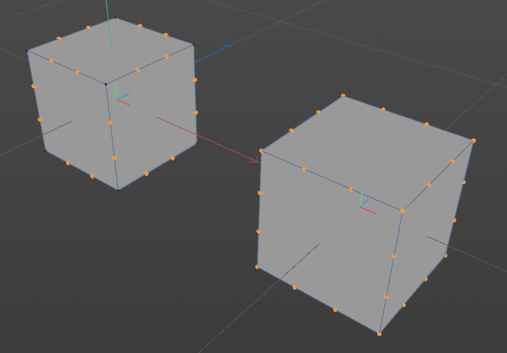

                ferdinand @ferdinand
                Dear community,
                I had a little Sunday evening session with the problem discussed here in the thread, how to create neighboring Ngons in Python, and wrote a narrative example for it. The problem is not rocket science, but since the topic of creating Ngons has been addressed multiple times for Python, I thought I give it a go. Please note that the solution described here is a pure data structure problem. A question type which lies out of scope of support for the SDK Team. I am providing this solution as a private person, and this is not a commitment of ours to do this regularly.
                Everything else should be explained in the script.
                A copy of an Ngon mesh created with the hashing/indexing approach. The mesh contains neighboring Ngons which would have been melted together with the more brutish approach provided in my prior posting:
                The code:

                    # Create a polygon object of matching size to copy the polygon data to.
                    copy = c4d.PolygonObject(op.GetPointCount(), op.GetPolygonCount())
                    copy.SetName(f"Copy of {op.GetName()}")
                    # Copy over manually the vertex and polygon data.
                    copy.SetAllPoints(op.GetAllPoints())
                    for i, item in enumerate(op.GetAllPolygons()):
                        cpoly = c4d.CPolygon(item.a, item.b, item.c, item.d)
                        copy.SetPolygon(i, cpoly)
                    copy.Message(c4d.MSG_UPDATE)
                    # Before we move on, we move the copy a little bit, so that we can see
                    # better what the outcome is, when we later insert it.
                    mg = copy.GetMg()
                    mg.off += c4d.Vector(500, 0, 0)
                    copy.SetMg(mg)
                    # Create the ngon information.
                    CreateNgonGroupings(copy, ngonGroups)
                    # Insert the new object into the document and let Cinema crunch on it.
                    doc.InsertObject(copy)
                  I am back at work now, if any questions remain, please feel free to ask them.
