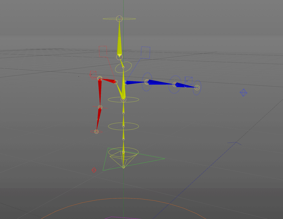

      I'm trying to mirror a Character Object pose on the XY plane. I would like to assign the rotation of each shoulder to the other. The script in effect would look like this: Mirror.gif
      I have read the API documentation on Matrix Fundamentals. Here's what I've tried so far:
      • Setting the matrices of each shoulder with the other shoulder multiplied in X by -1. The rotations were incorrect because (I think) the shoulders' Z axes are different.

        first of all: I assume you actually mean a reflection on the YZ plane, since the symmetry in your example is along the X axis. A reflection on the XY plane would mean reflecting along the Z axis. Also that linked thread included quite some guess work for me, so that script does something different.
        Your approach is correct, here is a version I would consider slightly more readable.
        def reflect_object_on_yz_plane(op):
            # Get the global matrix of our object.
            mg = op.GetMg()
            # Get the offset (position) of the global matrix with a reflected x
            # component.
            off = c4d.Vector(-mg.off.x, mg.off.y, mg.off.z)
            # Construct the x column vector (c4d defines the axis in column vectors in
            # its transform matrices) by copying and mirroring the x column vector of
            # the object's global matrix on its x axis.
            v1 = c4d.Vector(-mg.v1.x, mg.v1.y, mg.v1.z)
            # The same for the y column
            v2 = c4d.Vector(-mg.v2.x, mg.v2.y, mg.v2.z)
            # The same for y column
            v3 = c4d.Vector(-mg.v3.x, mg.v3.y, mg.v3.z)
            # The new matrix.
            mg = c4d.Matrix(off, v1, v2, v3)
            # Set the global matrix of our object.
            op.SetMg(mg)
        I am not sure what you mean by incorrect z axis, but note that coordinate systems and therefor its matrices are either left handed or right handed (Cinema is left handed), which dictates the relation of the positive quadrants of the coordinate system. So I assume, what you mean by incorrect z axis, is a change of orientation of the z-axis gizmo in the editor, but that is actually normal.
