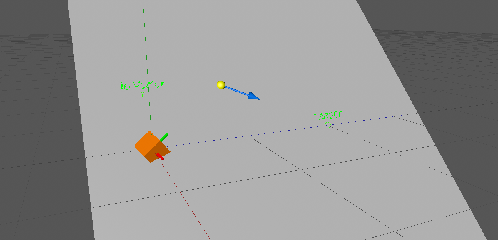

      In this image, the yellow sphere and blue arrow are what I need to align towards the target by rotating the matrix of the orange cube.

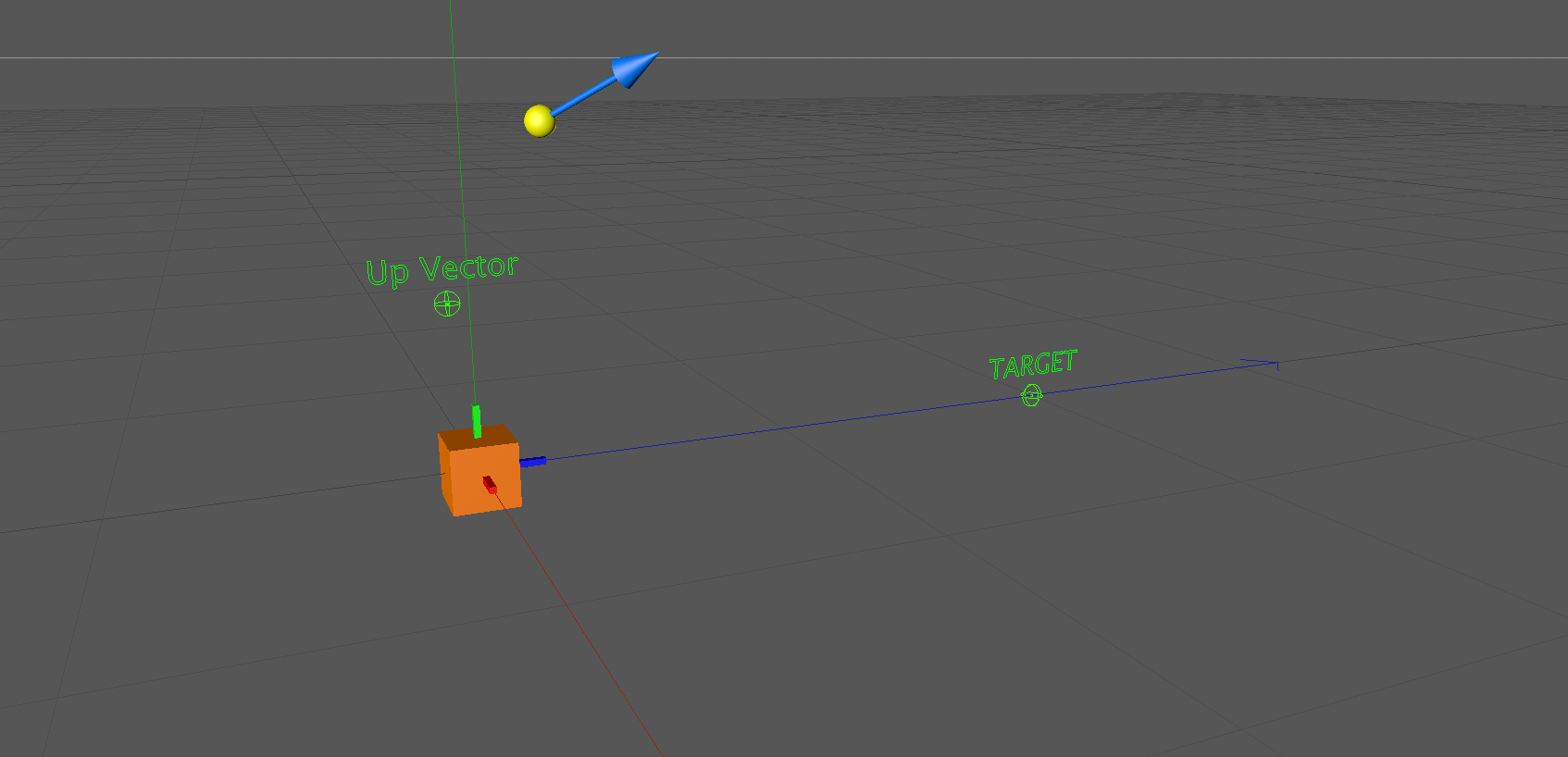

      Here they are aligned (which shows how the orange cube has been rotated until the blue arrow is pointing directly at the target):
      And here's an image with a plane slicing through the orange cube's origin, the up vector, the yellow sphere, and the target (which demonstrates how I need to align the entire system):
      I'm guessing this is just a matter of performing a whole bunch of space transforms and some dot/cross vector math, but I'll be damned if I can even figure out where to start. Originally I thought this might be solvable using simple trig (since the angle between the blue arrow and direction towards the orange cube will always be static, and since you know the distance from the yellow sphere to the orange cube and from the orange cube to the target point, you can derive the rest of the angles of the triangle that forms)- but that doesn't solve the fact that the orange cube needs to be rotated in such a way that the blue arrow always lands up pointing at the target.

          Hi @cmpxchg8b and @a_block ,
          I don't know much about matrix, but here is what I found.
          If the point with arrow should rotate to aim, then all the possible position of the point must lay on the sphere surface which sphere's center is the parent object.
          And one point and a vector can form a line in space.
          So the question becomes a line-sphere intersection problem.
          After solving the equations, we can get 2 points: original point and transformed point(s).
          After that, we can find the transform matrix between 2 points.
