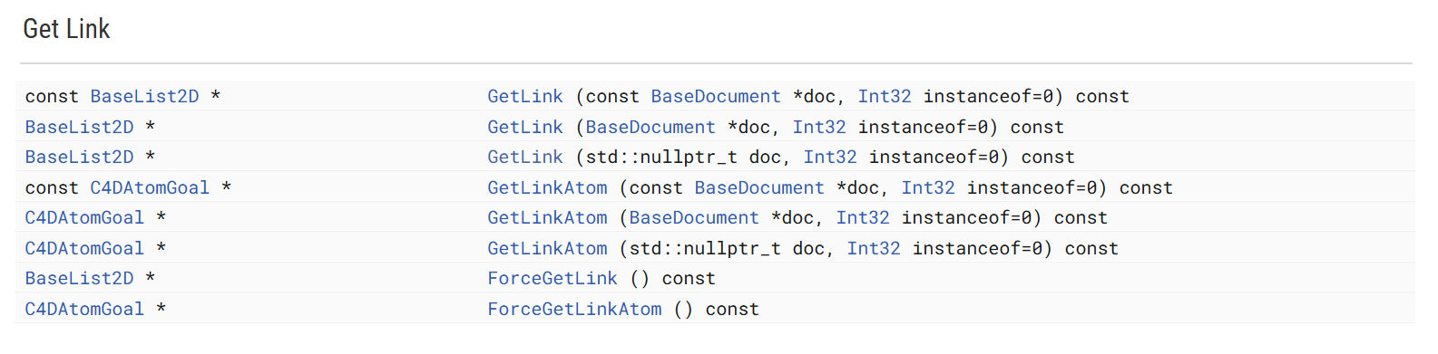

        Thank you for your question. A BaseLink always requires a document within which it shall be resolved, when you do not provide one, it just takes the active document.
        So, your question is a bit ambivalent. Internally, a BaseLink is based on GeMarker which identifies a scene element (C4DAtom) over the mac address of the creating machine, the time of creation, and a random UUID. The value is a constant attached to the scene element expressed as 16 bytes of data.
        So, this value is persistent over reload boundaries and does not care for the document it is in - although copying a scene element will usually cause it to get a new marker, unless you tell Cinema 4D explicitly to also copy the marker. You can easily query multiple documents for containing a given C4DAtom via a BaseLink. But unless you deliberately forced markers to be copied, it is not possible that multiple documents contain the same C4DAtom.
