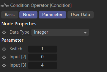

      I want to set condition node input port (GvPort) value, but it seems I can not do this via __settitem__ / SetParameter, is this is a limit or I do it in wrong way?
      Cheers~
      DunHou

        Hey @Dunhou,
        Thank you for reaching out to us. This is probably possible, but I'll have to check with a debugger myself. These are dynamically generated ports which tend to be a pain in the butt in Xpresso, as pretty much every node type handles them slightly differently, and even by looking at our source code you often do not get any wiser. My guess would have been that it is something like c4d.DescID(c4d.DescLevel(c4d.GV_CONDITION_INPUT, c4d.DTYPE_SUBCONTAINER, condNode.GetType()), c4d.DescLevel(0, c4d.DTYPE_REAL, 0)) or the same but other values for the second desc level such as 1000, 2000, etc. instead of 0. GV_CONDITION_INPUT is defined in the description as the input group.
        I will have to attach a debugger to see what is going on, but where I am currently working from, I have no compiled version of Cinema 4D. Will check in the next days from my Mac, where I do have a compiled version. You can check this thread for context, the function PythonNodeLayerShaderAccess goes into some details (a Python node also has a dynamic/variadic number of in- and output ports).

          Hey,
          so, I actually did get it right, I apparently just did not check properly when I tested the common case of second level IDs of dynamic properties starting off at 1000.

              # Count the number of input ports on the Condition node. For our case, a freshly instantiated
              # node we do not really have to do this, since there will always be static "Switch" port and
              # two dynamic input ports. But when we are working on an existing graph, we have to count the
              # ports to know how many dynamic ports there are.
              inputPorts: list[GvPort] = condNode.GetInPorts()
              portCount: int = len(inputPorts)
              # There is no predefined symbol for this, the implementation counts just ports, so dynamic ports
              # start at 1001 because the input port GV_CONDITION_SWITCH has the ID 1000.
              idDynamicStart: int = 1001
              # Iterate over all dynamic input ports (-1 -> skipping the first static "Switch" port).
              for i in range(portCount - 1):
                  # Define the DescID for the dynamic input port.
                  did: c4d.DescID = c4d.DescID(
                      # The first desc level for variadic/dynamic ports is always a sub container. For a
                      # condition node where the variadic ports can only be inputs and always are of one type,
                      # this is GV_CONDITION_INPUT. Other nodes which can have variadic ports of different
                      # types (like the Python node) have different sub container IDs for inputs and outputs,
                      # e.g., IN_REAL for all real inputs, IN_STRING for all string inputs, OUT_LONG for all
                      # long outputs, etc.
                      # And the second desc level is the dynamic port ID, starting at 1001 for the first dynamic
                      # input port, 1002 for the second dynamic input port, and so on. It unfortunately not very
                      # standardized, where these start.
                      c4d.DescLevel(idDynamicStart + i, c4d.DTYPE_REAL, 0)
                  # Set the value of the dynamic input port to some float value.
                  result: bool = condNode.SetParameter(did, float((i + 1) * 10), c4d.DESCFLAGS_SET_0)
                  if not result:
                      print("Failed to set value on port index:", i)
              # Or another common workflow, we want to set a dynamic port by port label (instead of knowing
              # the index in advance).
              # Find the first port that starts with "Input".
              targetLabel: str = "Input"
              targetPort: GvPort | None = next((port for port in inputPorts
                                                if port.GetName(condNode).startswith(targetLabel)), None)
              # We found a port with that label.
              if targetPort is not None:
                  # Unlike in the Nodes API, we cannot set the value on a port directly, we always have to go
                  # through the node and use a DescID to identify the port. So we must find the index of the
                  # port in the input ports list to calculate the dynamic port ID.
                  index: int = inputPorts.index(targetPort)
                      c4d.DescID(
                          c4d.DescLevel(idDynamicStart + (index - 1), c4d.DTYPE_REAL, 0)
                      99.9, # Set the value to 99.9
                      c4d.DESCFLAGS_SET_0
                  if not result:
                      print("Failed to set value on port:", targetPort.GetName(condNode))
