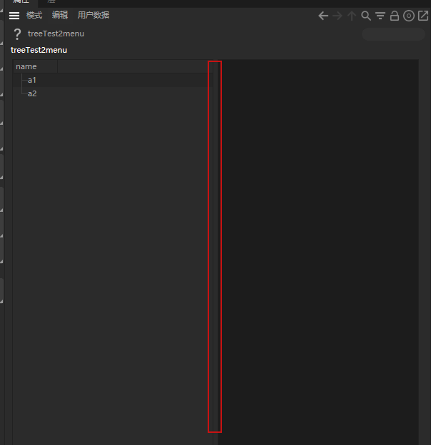

      I'm implement some functions like model manage system, similar with asset browser, but the data come from Remote DataBase,so this is some questions on my way。

      1.is there any way to add a separator in the model of the two control, so I'can drag to resize,
      like asset browser.

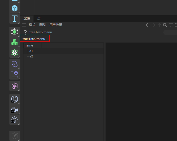

      2.how to hide this title? It's seem useless

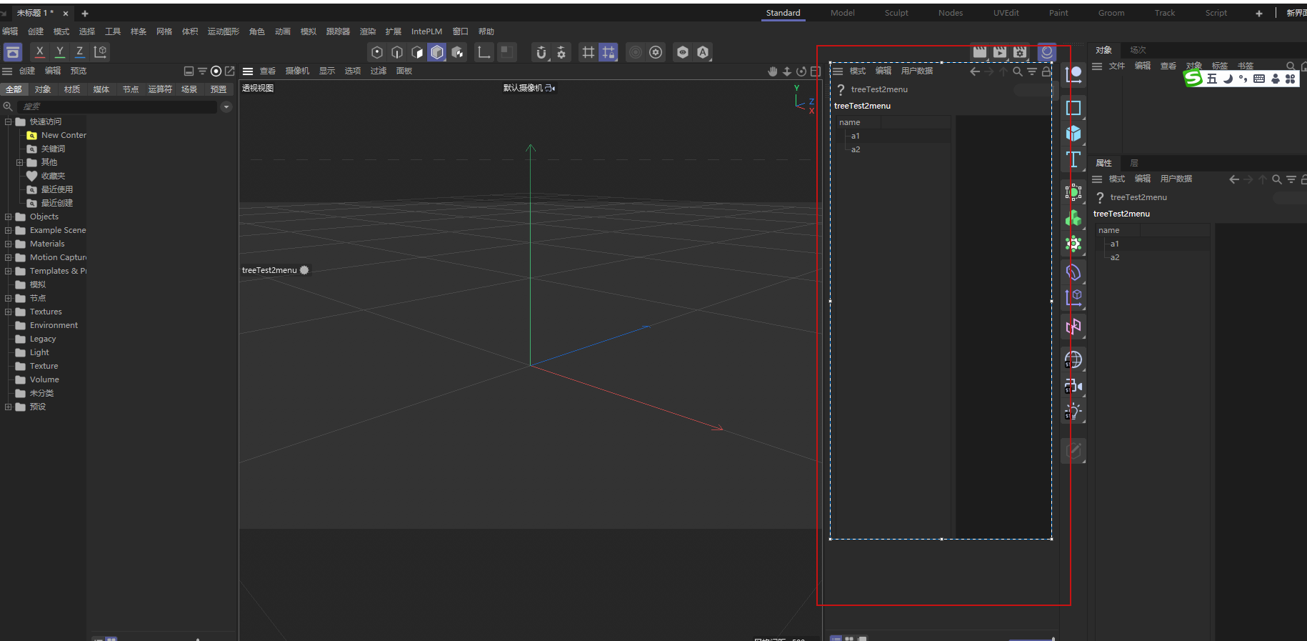

      3.can embed the Dialog like asset browser?

        ferdinand @mogli
        Hey @mogli,
        Thank you for reaching out to us.
        1. is there any way to add a separator in the model of the two control, so I'can drag to resize
        Well, you can also add a separator to make it more visible, but the key thing to do, is to allow weights for a group. When you have this group structure
        GROUP ID_MY_WEIGHTED_GROUP
            COLUMNS 1;
            SCALE_H;
            SCALE_V;
            ALLOW_WEIGHTS;
            GROUP ID_SUB_GROUP_A {SCALE_H; SCALE_V;}
            GROUP ID_SUB_GROUP_B {SCALE_H; SCALE_V;}
        The user can change the height of the groups ID_SUB_GROUP_A and ID_SUB_GROUP_B by dragging between them as you did in your screencast. The relevant flag is here ALLOW_WEIGHTS, and if you want to use code to create the layout, you must pass BFV_GRIDGROUP_ALLOW_WEIGHTS as part of the group flags for the GeDialog.GroupBegin call for ID_MY_WEIGHTED_GROUP. You can also save and load group weights for a dialog with the methods GeDialog.GroupWeightsLoad and .GroupWeightsSave()
        This title comes from the ToolData plugin you are implementing. I agree that the duplication of the name is a bit distracting. I am not sure if it has always been there, but for now, you cannot change that.
        Edit: So, I checked, and the duplication of the title string goes back to at least S22 (I do not have any older versions installed) and was therefore likely always there. It is only that it became more distracting with the new layout, as the contrast between the two strings has increased (could also be that this is just a perception thing with the darker background). This is for example how it looked in R23:
        We will see what we can do, but there will not be any immediate fixes, as ToolData itself does not have the highest priority and we will also be reluctant to remove title strings other plugins might rely on.
        Yes, you can, find out in this thread how to do it.

            hi @ferdinand about 3,I'm try to exeute the example code by the link provided, but It seems not work,It opens as Separate Window.
              Hey @mogli
              as described in the posting and the example, Cinema 4D relies on layouts, you cannot programmatically inject a dialog into a layout. You must open and dock the dialog once manually, and subsequent clicks on the button will then have the desired behaviour. See this posting for more information on how to handle layout files.
              The bottom line is:
              • You can implement the collapsing behaviour akin to the Asset Browser, Timeline/Dopesheet, or Coordinate Manger.
              • You can provide (partial) layouts with your plugin and programatically load them for the user.
              • You cannot inject a partial layout or a single dialog into an existing layout of a user.
              • Even our internal tools do not do that, they rely on the layout files which are provided with Cinema 4D.
              • This is an intentional design decision by us.
