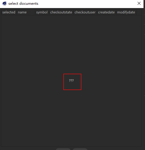

      when i'm using TreeViewCustomGui(python),there is some problem。
      1.CUSTOMGUI_TREEVIEW is empty,this is some ??? showing in the form😵

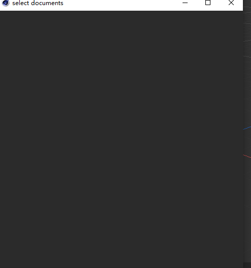

      2.when i use DLG_TYPE_ASYNC, the open form show empty, if i instead of using DLG_TYPE_MODAL it shows normal。

        The ??? text is intended an indicates an empty treeview, i.e., when its root contains no items. You are supposed to display here text as for example 'Drag documents into this field'. You can set the text with the method TreeViewFunctions.EmptyText().

          @ferdinand thank you very much,it had been solved According to your method,have a good day!
