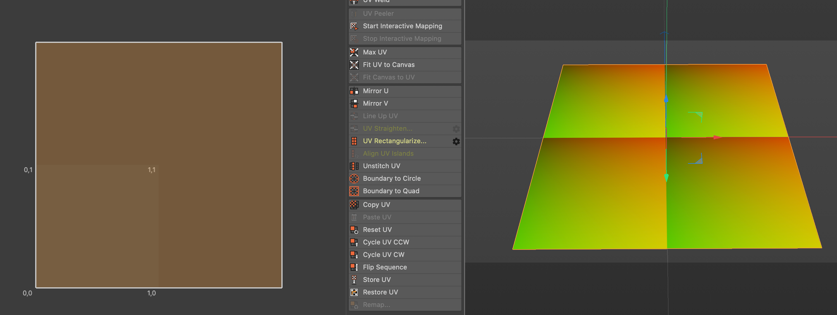

      I need to access uvw coordinartes outside of the 0-1 boundary, in a ShaderData.
      In UV Edit mode, I scaled plane's uvw to go beyonx 1,1, but the coordinates passed to ShaderData.Output() always normalized to 1,1.
      How can I access the actual uvs I need?
      Maybe some trick on material tag?
      Some external renderers use this
      for UDIM textures, so it looks possible.
      My plugin is in C++ but, but I made a simple test plugin and it has the same issue...
      Py-ShaderUvw.pyp
      def Output(self, sh, cd):
      	c = c4d.Vector( cd.p.x, cd.p.y, 0 )
      	return c
      Here's how the UVW is setup, the viewport uvws are repeating...
      Confirming that the UVW tag contains coordinates up to 2.0...
      And the actual render is even stranger, it makes no sense...

        hi,
        the V axis have been reverse in the UVs editor but not internally. So you have to introduce a 1-V operation.
        Float posX = cd->p.x;
        Float posY = 1 - cd->p.y;
        The same issue talked in this thread as you already pointed out
        Manuel

          @m_magalhaes Thank you, that works.
          It would be super useful to have this piece of information on the Output() reference.
          What about having the correct uvw on the viewport, is it possible?

            • rsodreR Offline
              rsodre @Manuel
              @m_magalhaes Difference between the viewport uvs and render uvs.
              This is the render, it is correct now, with uvs from 0..2:
              But the material rendered at viewport does has normalized uvs (0...1):

                • ManuelM Offline
                  Manuel
                  hi,
                  I've opened a bug report for that.
                  The viewport should reflect as mush as we can the final render.
                  Manuel
                  MAXON Registered Developer

                    Manuel
                    hi,
                    the Shader is limited to 0,1 uvs space in the viewport.
                    That's exactly what you can see for example with the noise shader. Except this shader have a special mode (HQ noise) so they can be displayed properly.
                    You can also see that with the brick shader. (HQ Noise doesn't help in that case)
                    Manuel

                      rsodre @Manuel
                      @m_magalhaes Ok, is it going to be fixed on the bug report or is that a limitation we have to live with?

                        hi,
                        the bug report have been defined as a limitation.
                        It doesn't mean that it will never be fixed, but not now.
                        Manuel
