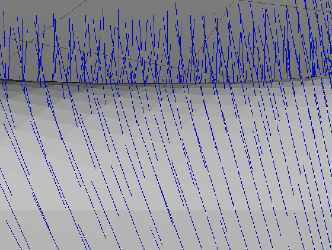

      I was not happy with the performance using BaseDraw::LineStripBegin() / BaseDraw::LineStrip() / BaseDraw::LineStripEnd() to draw thousands of strands on the viewport, so I tried using GlProgramFactory and GlVertexBuffer from gl.h, exemplified on the sdk source gl_test_object.cpp. The performance improved was amazing, viewport fps raised up to 3 times.
      But those functions are marked as undocumented, and I hope that's very different from the private, that shall never be commented, because some issues arised that I'm unable to solve.
      First, bd->SetDrawParam( DRAW_PARAMETER_LINEWIDTH, 2 ); does not work when drawing with DrawSubBuffer().
      DRAW_PARAMETER_LINEWIDTH is marked in the docs as (OpenGL only), but actually looks like is the inverse.
      How can I set like width for DrawSubBuffer()?
      What OpenGL does DRAW_PARAMETER_LINEWIDTH refers to?
      And some lines seem broken, with gaps in between, usually on concave surfaces. Looks like some depth precision problem.
      How to control depth read/write using those functions?

            Just found my problem, nothing to do with the drawing API...
            bd->SetDrawParam( DRAW_PARAMETER_SETZ, DRAW_Z_ALWAYS );
            It was setting the depth fragment on all the strands, occluding itself sometimes!
