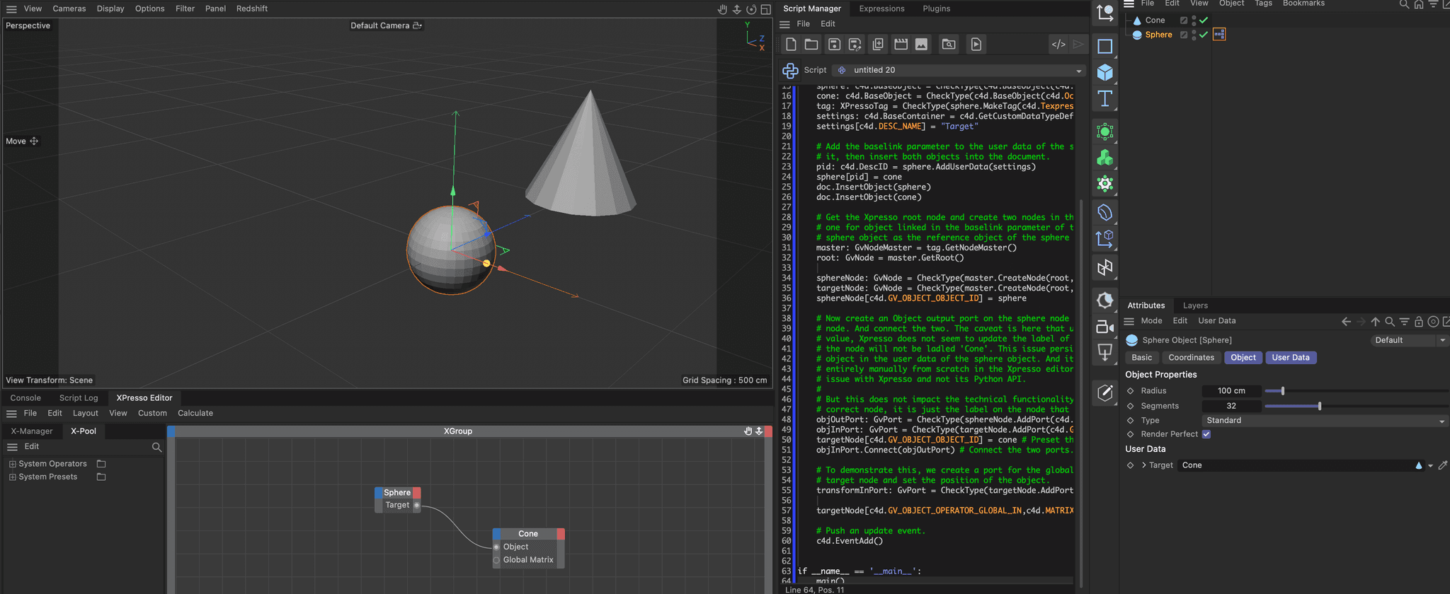

      What I get with the above code:
      What I need it to do:
      To later link the target with the object.
      Thank you for your time.

        Find my cleaned up solution below.
        Result
        Code
        import mxutils
        from c4d.modules.graphview import GvNode, GvPort, GvNodeMaster, XPressoTag
        from mxutils import CheckType
            # All these #CheckType calls make sure that the return value of something is not None. The
            # allocation of scene elements can fail, and it is advisable to check. See the docs for details.
            # Create a sphere and a cone object, create an XPresso tag on the sphere, and then create the
            # parameter description for a baselink named 'Target'.
            sphere: c4d.BaseObject = CheckType(c4d.BaseObject(c4d.Osphere))
            cone: c4d.BaseObject = CheckType(c4d.BaseObject(c4d.Ocone))
            tag: XPressoTag = CheckType(sphere.MakeTag(c4d.Texpresso))
            settings: c4d.BaseContainer = c4d.GetCustomDataTypeDefault(c4d.DTYPE_BASELISTLINK)
            settings[c4d.DESC_NAME] = "Target"
            # Add the baselink parameter to the user data of the sphere object and link the cone object in
            # it, then insert both objects into the document.
            pid: c4d.DescID = sphere.AddUserData(settings)
            sphere[pid] = cone
            doc.InsertObject(sphere)
            doc.InsertObject(cone)
            # Get the Xpresso root node and create two nodes in the graph. One for the sphere object and
            # one for object linked in the baselink parameter of the sphere object. Finally, link the
            # sphere object as the reference object of the sphere node.
            master: GvNodeMaster = tag.GetNodeMaster()
            root: GvNode = master.GetRoot()
            sphereNode: GvNode = CheckType(master.CreateNode(root, c4d.ID_OPERATOR_OBJECT))
            targetNode: GvNode = CheckType(master.CreateNode(root, c4d.ID_OPERATOR_OBJECT))
            sphereNode[c4d.GV_OBJECT_OBJECT_ID] = sphere
            # Now create an object output port on the sphere node and an object input port on the target
            # node and connect the two. The caveat is here that unless we first manually set the port
            # value, Xpresso does not seem to update the label of the node when we set the connection. I.e.,
            # the node will not be labeled 'Cone'. This issue persists when we later manually change the
            # object in the user data of the sphere object. And it also happens when we create the setup
            # entirely manually from scratch in the Xpresso editor. So, this seems to be more a general
            # issue with Xpresso and not its Python API.
            # But this does not impact the technical functionality of the setup, it still always affects the
            # correct node, it is just the label on the node that is misleading.
            objOutPort: GvPort = CheckType(sphereNode.AddPort(c4d.GV_PORT_OUTPUT, pid))
            objInPort: GvPort = CheckType(targetNode.AddPort(c4d.GV_PORT_INPUT, c4d.GV_OBJECT_OPERATOR_OBJECT_IN))
            targetNode[c4d.GV_OBJECT_OBJECT_ID] = cone # Preset the port value to update the label.
            objInPort.Connect(objOutPort) # Connect the two ports.
            # To demonstrate this, we create a port for the global transform of the object wrapped by the
            # target node and set the position of the object.
            transformInPort: GvPort = CheckType(targetNode.AddPort(c4d.GV_PORT_INPUT,
                                                                   c4d.GV_OBJECT_OPERATOR_GLOBAL_IN))
            targetNode[c4d.GV_OBJECT_OPERATOR_GLOBAL_IN,c4d.MATRIX_OFF] = c4d.Vector(300, 300, 0)
            # Push an update event.

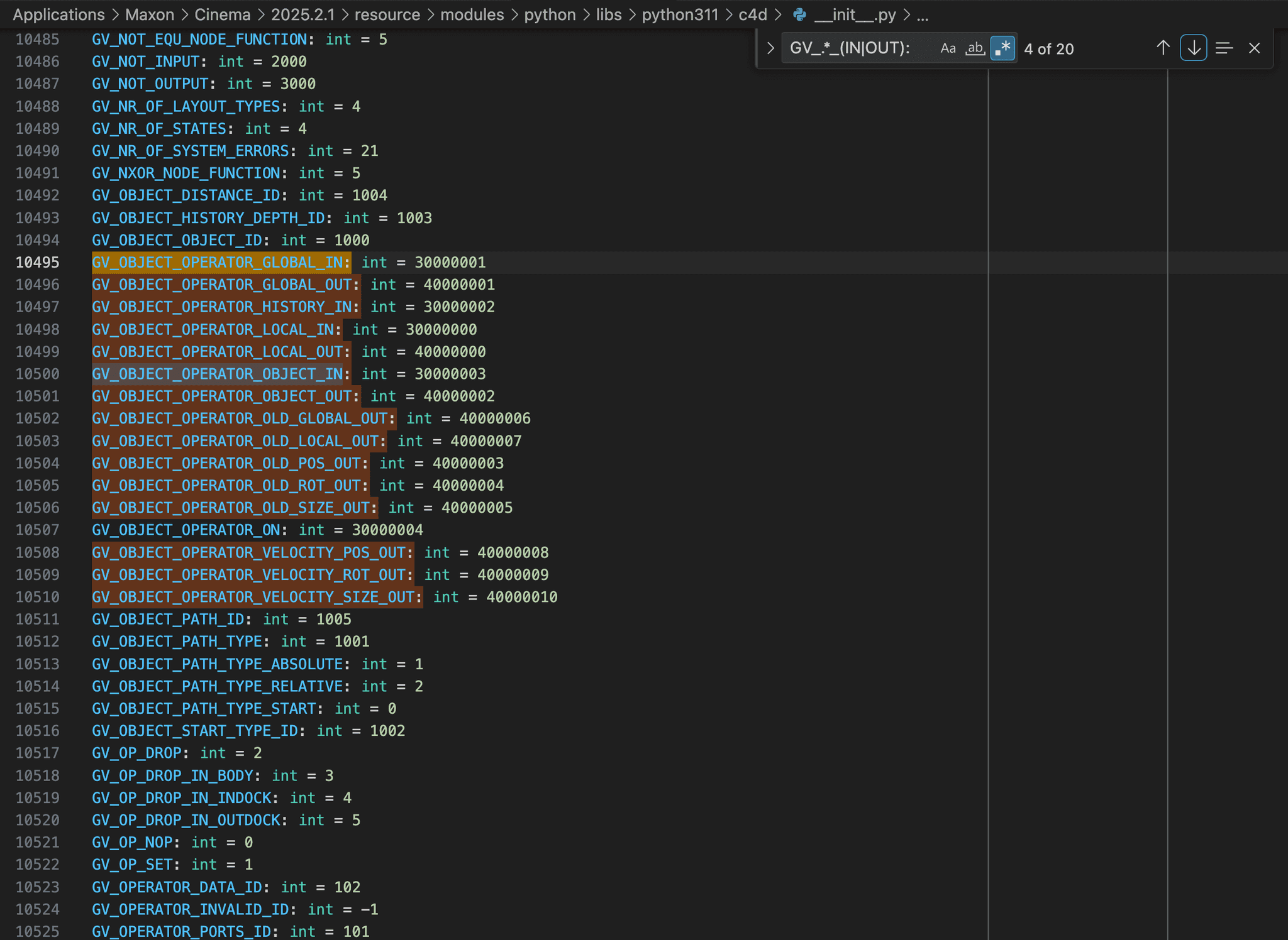

          Also where I can find all the GV_ options and ID_ options for creating nodes, and ports ?
            ferdinand @JoelJohera
            Hey,
            the overview for GV ops can be found here here, accessible from our types and symbols index. For the dedicated resources you would have then to look into our resource index, specifically in the graph view section. There you will then find the parsed resources for operators and could look for example at the Object Operator.
            The caveat is that there is a small irregularity with the gv object node as it redefines some of its resource parameters for their input and output port. The only other operator type which does seem to do that is hair collision operator for its velocity port. It has likely something to do with the fact that both these operators wrap scene elements. But the resources document all these ports.
            If you just want a plain technical top-down view on symbols you can also look at /{c4d}/resource/modules/python/libs/python311/c4d/__init__.py. There you can see it is only a handful (20 to be exact) ports which follow this _IN|_OUT postfix scheme:

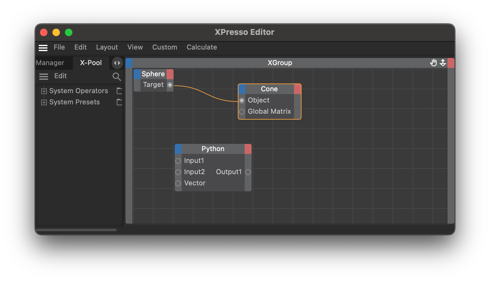

              Thank you so much for the resources. I asked because now I am trying to create a Python node, and I tried to specify the input port as c4d.DTYPE_VECTOR, but it does not work.
                Hey @JoelJohera,
                Please stop asking non-follow-up questions in a thread, when you have a new question, please open a new thread.
                With that being said:
                    # Create a Python node.
                    pythonNode: GvNode = CheckType(master.CreateNode(root, c4d.ID_OPERATOR_PYTHON))
                    # Create a vector input port on it. The syntax for the dynamic ports of a Python node is a bit
                    # weird and I also only found out how this works by dragging parameters to the console and by
                    # inspecting the description of the node.
                    vectorInPort: GvPort = CheckType(pythonNode.AddPort(
                        c4d.GV_PORT_INPUT,
                        # The plain symbols, e.g., #GV_OBJECT_OPERATOR_OBJECT_IN are only a short hand form for how
                        # parameter IDs are defined under the hood: DescIDs. There are plenty of postings about this
                        # on the forum, just search for 'DescID' and my user name, one is for example here:
                        # https://developers.maxon.net/forum/topic/14342/howto-set-keyframes-for-posxyz-rotxyz-scalexyz-with-a-script/15
                        c4d.DescID(
                            # The IDs for the dynamic ports are really weird. The first level is of type sub-container,
                            # and has an ID such as IN_VECTOR, OUT_VECTOR, IN_REAL, OUT_REAL, etc. The second level
                            # then describes the the actual data and its ID. The IDs seem to start at 1001, and since
                            # a Python node has two default ports, I am putting mine at 1003. The levels also have
                            # some truly wild owners (the third parameter of a level which set here to 0). I checked
                            # its not the type ID of the op. But as so often, you can also null the owner ID and it
                            # still works.
                            c4d.DescLevel(c4d.IN_VECTOR, c4d.DTYPE_SUBCONTAINER, 0),
                            c4d.DescLevel(1003, c4d.DTYPE_VECTOR, 0)
                            # These IDs are in fact so weird, that our parameter drag and drop misfires and produces
                            # malformed DescIDs (when you press enter on such dragged parameter, it raises an
                            # AttributeError). But dragging them can still be useful to figure these a bit hand-wavy
                            # type symbols such as IN_VECTOR, OUT_VECTOR, etc.
