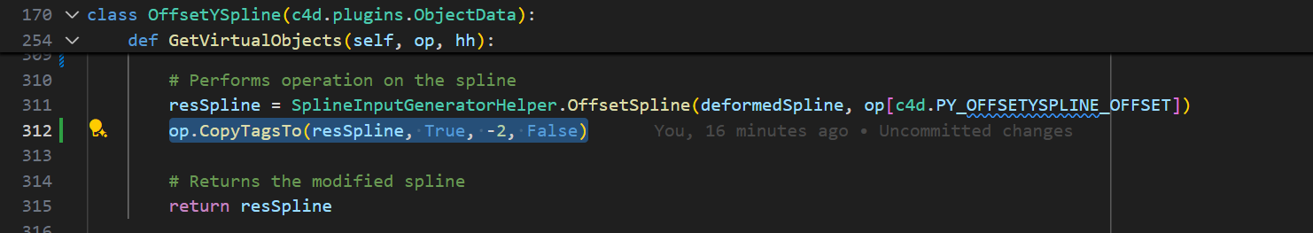

        op.CopyTagsTo(resSpline, True, -2, False) will effectively copy the rope tag into the cache and for me this will then work as expected. But this call to CopyTagsTo is very non-conformant, as in Python it is documented to take three Boolean arguments at the end, not BaseObject, bool, int, bool. Its internal signature is actually BaseObject, int, int, int but even there this is non-standard, as in C++ this is meant to take NOTOK (-1), false (0), and true (1) as the last three arguments. But simulation uses here -2 for special purposes.
        All this indicates why this whole code example was never a good idea, as it publishes a hacky approach without making clear how hacky it is. And hacky things will always entail more hacky things, point and case the CopyTagsTo call to make it work with simulation. You can copy this 'fix' but I would suggest to use a deformer when possible. Splines that have input objects are not a good pattern, especially in this GVO + GC workflow.
