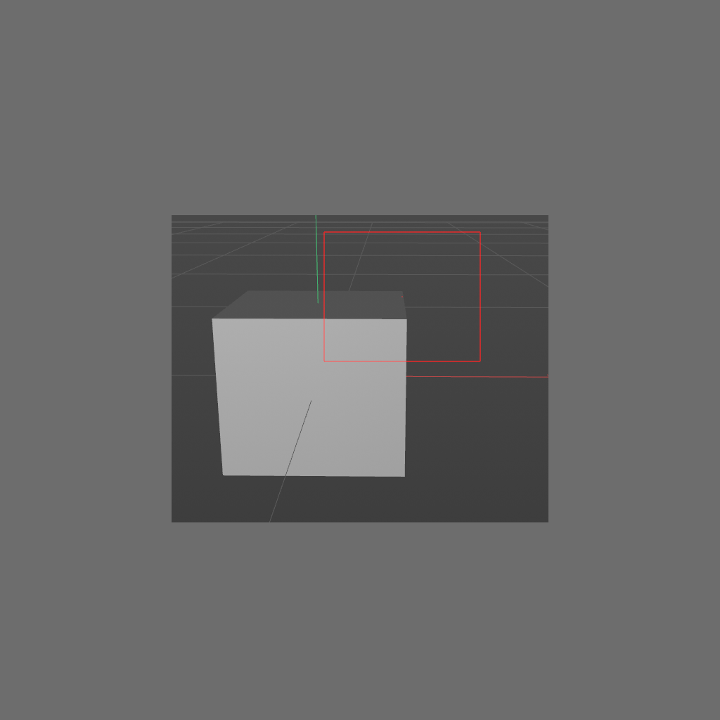

  • How to get Viewport pixel color
    Cinema 4D SDK s26 python
    549 Views
    chuanzhenC
    @ferdinand Hi,i use RenderDocument in python,although it is a little slow and needs to wait for a second, it works successfully. Thanks for your help,gif show it works: [image: 1660008431592-ssss.gif]

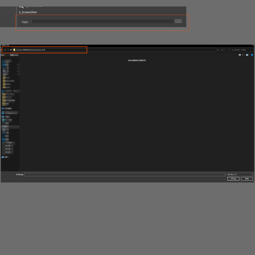

  • Filename Gui how get empty folder path
    Cinema 4D SDK python s26
    487 Views
    chuanzhenC
    @ferdinand Thanks. I create Filename Gui in CreateLayout it work,this is code: bc = c4d.BaseContainer() bc.SetBool(c4d.FILENAME_DIRECTORY,True) self.AddCustomGui(1012, c4d.CUSTOMGUI_FILENAME,"",c4d.BFH_SCALEFIT, 50, 20, bc)
