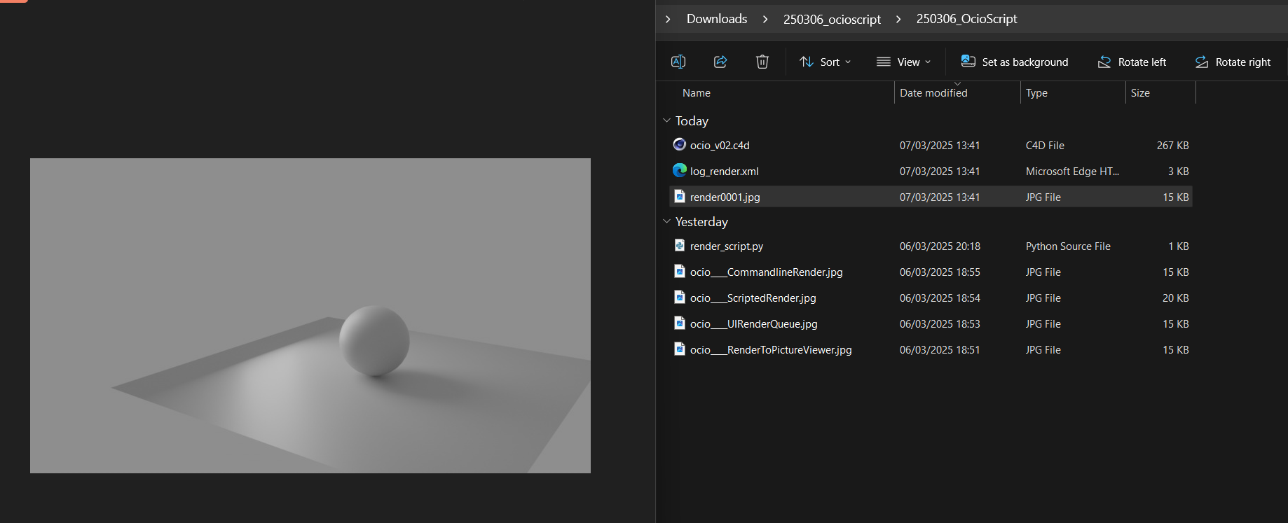

                  Reproduction steps:
                  250306_OcioScript.zip
                  1. Open the scene.
                  Render with Baked OCIO:
                  2) Execute "Render to Picture Viewer" (rename the output).
                  3) Execute "Add to Render Queue", start it (rename the output).
                  4) Render via commandline (rename the output).
                  Render without Baked OCIO:
                  5) Execute the script (rename the output).
                  Request:
                  No matter how C4D saves a rendered frame, the file written should always look the same.
