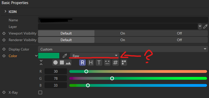

<?xml version="1.0" encoding="UTF-8"?><rss xmlns:dc="http://purl.org/dc/elements/1.1/" xmlns:content="http://purl.org/rss/1.0/modules/content/" xmlns:atom="http://www.w3.org/2005/Atom" version="2.0"><channel><title><![CDATA[Change render Space (Color Profile) - how?]]></title><description><![CDATA[<p dir="auto">Dear Dev Team,</p>
<p dir="auto">I have a plugin that renders (Standard C4d Renderer - fastest for plain color at the time) a flat color rendering (no dithering, shading, or lights) of object display color (yes plain object color, no textures). Input and output have to be the exact same color, to evaluate if the camera "sees" an object. This plugin worked before 2025.2 with "sRGB linear" workflow.<br />
Render output looks like this (the more objects the more colors of course):<br />
<img src="/forum/assets/uploads/files/1787667525100-example.png" alt="example.png" class=" img-fluid img-markdown" /></p>
<p dir="auto">Quick solution for me is to change the "Render space" to legacy "sRGB linear workflow"<br />
<img src="/forum/assets/uploads/files/1787667885462-2026-08-25-16_24_25-convert-render-space.png" alt="2026-08-25 16_24_25-Convert Render Space.png" class=" img-fluid img-markdown" /><br />
<strong>Question: -&gt; how would I do that in python ?</strong> (and back to the users render Color-space so it does not mess up the users settings)</p>
<p dir="auto"><em>Is there a better way to get Input object color and rendered color to be exactly the same with no color space change? A color transform on the bmp? how would I do that?</em></p>
<p dir="auto">thank you for your time</p>
