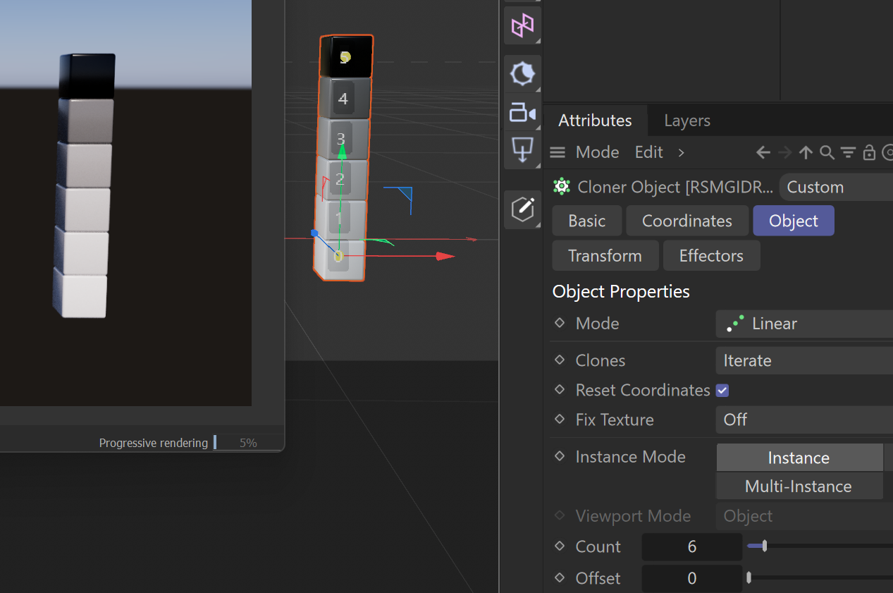

Can you help me find out the rule of how RSMGIDRatioColor works when it is applied to a cloner in Honeycomb mode? According to the document <a href="https://help.maxon.net/r3d/cinema/en-us/Default.htm#html/Cinema+4D+MoGraph.html#Cinema4DMoGraph-RSMGIDRatioColor" target="_blank" rel="noopener noreferrer nofollow ugc">here</a>: The index ratio of the clone as a grayscale color. I would expect the greyscale color for each instance would be (index/total number)  or (1 - index/total number). This means instances color will from pure black to white or white to black. And when cloner is in Linear mode, it matches this as below snapshot shows.</p>
<p dir="auto"><img src="/forum/assets/uploads/files/1762331926111-c6af6a9e-081a-40ab-980c-a944405f9869-image.png" alt="c6af6a9e-081a-40ab-980c-a944405f9869-image.png" class=" img-fluid img-markdown" /></p>

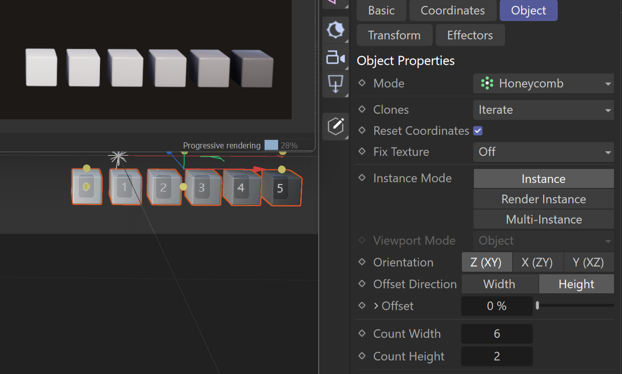

<p dir="auto">However, when the cloner is in HoneyComb mode, the first instance looks like pure white, however, the last instance is far from black as the below snapshot shows.</p>

<p dir="auto">So I'm wondering what the rule of RSMGIDRatioColor is for each instance when cloner is in Honeycomb mode.</p>

<p dir="auto">Thank you for your question. I just checked, and what RS calls the index ratio does not really have much to do with indices and is instead based on the uvw coordinate of a particle. This might be a bug, but you would have to talk with the Redshift team for that. Anyway, find below some Python code to emulate computing that 'index ratio'.</p>
<p dir="auto">Cheers,<br />
Ferdinand</p>
<h4>Result</h4>
<p dir="auto">I emulated your setup:</p>
<p dir="auto"><img src="/forum/assets/uploads/files/1762336177416-dfbeebb4-cce6-4ca1-bf31-76e78d3966c1-image.png" alt="dfbeebb4-cce6-4ca1-bf31-76e78d3966c1-image.png" class=" img-fluid img-markdown" /></p>
<h4>Code</h4>
