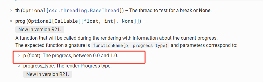

I used the <strong>example code</strong> from <strong>c4d.documents.RendeDocument()</strong> in the document, which indicates that the values returned by progress are between 0-1.0. However, in my actual use, there may be some values <strong>greater</strong> than <strong>1.0</strong><br />
<img src="/forum/assets/uploads/files/1761008460478-74fdd49f-2802-45eb-9756-b8e5fb46be7f-image.png" alt="74fdd49f-2802-45eb-9756-b8e5fb46be7f-image.png" class=" img-fluid img-markdown" /></p>
