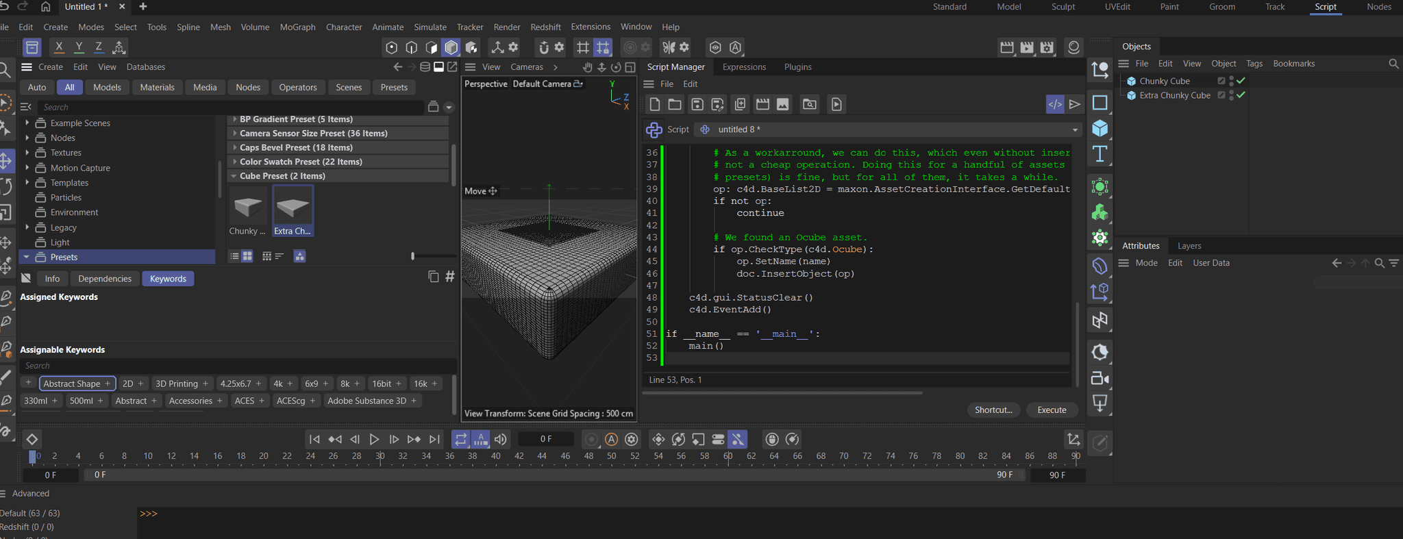

<p dir="auto">Thank you for reaching out to us. No, you do not need <code>PresetLoadArgs</code>, these are only required when you want to handle preset asset drag events. To load a preset, you just need <code>maxon.AssetCreationInterface</code>, which has been wrapped for Python. The primary method to use for this would be <code>GetDefaultSettings</code>, which unfortunately is broken. I provide below a workaround with  <code>maxon.AssetCreationInterface.GetDefaultObject</code>.</p>
<p dir="auto">Depending on what you want to do <code>GetDefaultObject</code> will work fine (when you just have to load a handful of predefined presets) or a bit clunky (when you have to discover all preset assets for a given scene element type).</p>
<p dir="auto">Because this concerns a bug, I have moved the topic.</p>
<p dir="auto">Cheers,<br />
Ferdinand</p>

<p dir="auto"><img src="/forum/assets/uploads/files/1746548944373-79019eff-94b4-4b2f-8d03-9d469f864a66-image-resized.png" alt="79019eff-94b4-4b2f-8d03-9d469f864a66-image.png" class=" img-fluid img-markdown" /></p>
