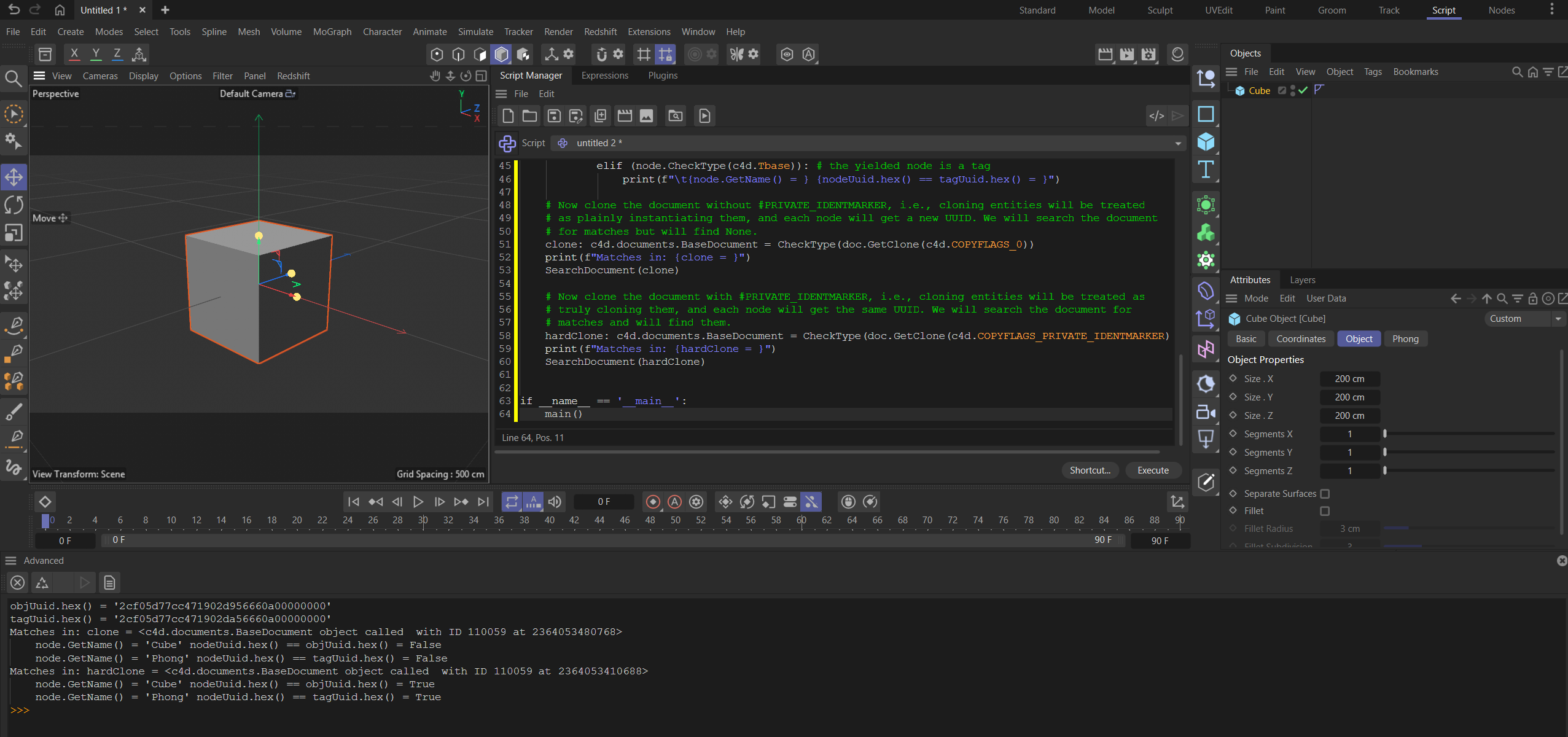

<p dir="auto">Here is some example code I have written in Python. Things are bit diffrent there, since in Python there is no <code>GeMarker</code> but only <code>MAXON_CREATOR_ID</code> (which also exists in C++) and in Python we have abstracted scene traversal in the form of <code>mxutils.RecurseGraph</code> and co. But it demonstrates the core principle.</p>
<h4>Result</h4>
<p dir="auto">When we clone the scene without <code>COPYFLAGS_PRIVATE_IDENTMARKER</code>, we are unable to find our object and its tag, when we do clone the scene with that flag, we find them both:<br />

<pre><code class="language-py">"""Demonstrates how to find the 'same' scene element in a cloned document, when comparing nodes to
an original document.
In Python we can do this via BaseList2D.FindUniqueID() and MAXON_CREATOR_ID. In C++ we can do this
also via GeMarker for which MAXON_CREATOR_ID is just a quasi-alias as it returns the 16 bytes of
the marker of the node it is invoked on.
Must be run with a scene with at least one object with at least one tag.
Warning:
    Be EXTREMLY careful with PRIVATE_IDENTMARKER. It is private for a reason, as one can really
    screw up things royally with it. Never insert multiple nodes with the same marker into one
    document. Never insert multiple documents (a `BaseDocument` is also a node) with same
    marker into Cinema 4D, e.g., via `InsertBaseDocument`. It is fine to have a temporary (non-
    inserted) document which is carbon copy of an inserted document (e.g., the active document).
import mxutils
from mxutils import CheckType
def main() -&gt; None:
    # Get the first object and its first tag in the scene or halt when there is none.
    obj: c4d.BaseObject = CheckType(doc.GetFirstObject())
    tag: c4d.BaseTag = CheckType(obj.GetFirstTag())
    # Get the MAXON creator IDs of the object and the tag, i.e., the 16 bytes stored by the
    # respective GeMarkers of the object and the tag. In Python GeMarker is not exposed, but
    # in C++ we can take both the direct GeMarker route and the a bit more indirect route via
    # MAXON_CREATOR_ID.
    objUuid: bytes = bytes(CheckType(obj.FindUniqueID(c4d.MAXON_CREATOR_ID)))
    tagUuid: bytes = bytes(CheckType(tag.FindUniqueID(c4d.MAXON_CREATOR_ID)))
    print(f"{objUuid.hex() = }")
    print(f"{tagUuid.hex() = }")
    def SearchDocument(domain: c4d.documents.BaseDocument) -&gt; None:
        """Searches the passed document for objects and tags that have the same #MAXON_CREATOR_ID
        as the first object and the first tag in the currently active document.
        node: c4d.BaseList2D
        for node in mxutils.RecurseGraph(
            domain, False, True, True, branchFilter=[c4d.Obase, c4d.Tbase], stopBranchingEarly=True):
            nodeUuid: bytes = bytes(CheckType(node.FindUniqueID(c4d.MAXON_CREATOR_ID)))
            if (node.CheckType(c4d.Obase)): # the yielded node is an object
                print(f"\t{node.GetName() = } {nodeUuid.hex() == objUuid.hex() = }")
            elif (node.CheckType(c4d.Tbase)): # the yielded node is a tag
                print(f"\t{node.GetName() = } {nodeUuid.hex() == tagUuid.hex() = }")
    # Now clone the document without #PRIVATE_IDENTMARKER, i.e., cloning entities will be treated
    # as plainly instantiating them, and each node will get a new UUID. We will search the document
    # for matches but will find None.
    clone: c4d.documents.BaseDocument = CheckType(doc.GetClone(c4d.COPYFLAGS_0))
    print(f"Matches in: {clone = }")
    SearchDocument(clone)
    # Now clone the document with #PRIVATE_IDENTMARKER, i.e., cloning entities will be treated as
    # truly cloning them, and each node will get the same UUID. We will search the document for
    # matches and will find them.
    # NEVER INSERT DOCUMENTS cloned with #COPYFLAGS_PRIVATE_IDENTMARKER into
    # Cinema 4D. Never insert a node with a marker/MAXON_CREATOR_ID into  a document
    # which already holds a node with such marker: I.e., never clone a node from a document
    # with that flag and then insert the result. Crashes are the 'best' outcome here, you could
    # seriously courrupt user scenes like this.
    hardClone: c4d.documents.BaseDocument = CheckType(doc.GetClone(c4d.COPYFLAGS_PRIVATE_IDENTMARKER))
    print(f"Matches in: {hardClone = }")
    SearchDocument(hardClone)
</code></pre>

<p dir="auto">I try to use the object from the cloned document, because I think the point count might change in a different frame. (The cloned document is at a different time)</p>
<p dir="auto">BTW, the cloned document is created by <code>doc-&gt;GetClone(COPYFLAGS::PRIVATE_IDENTMARKER, nullptr)</code>.</p>
</li>
</ol>
<p dir="auto">Sorry for the long list, please let me know if I need to split above questions to different topics.<br />
Now, all these questions above make me wonder if the usage is designed appropriately.<br />
Maybe from C4D design's point of view, it is not a proper design to let user specify the time (different with the current frame, and even can be a earlier frame) when the tag's data should be used to render all frames?</p>
<p dir="auto">Thank you!</p>
