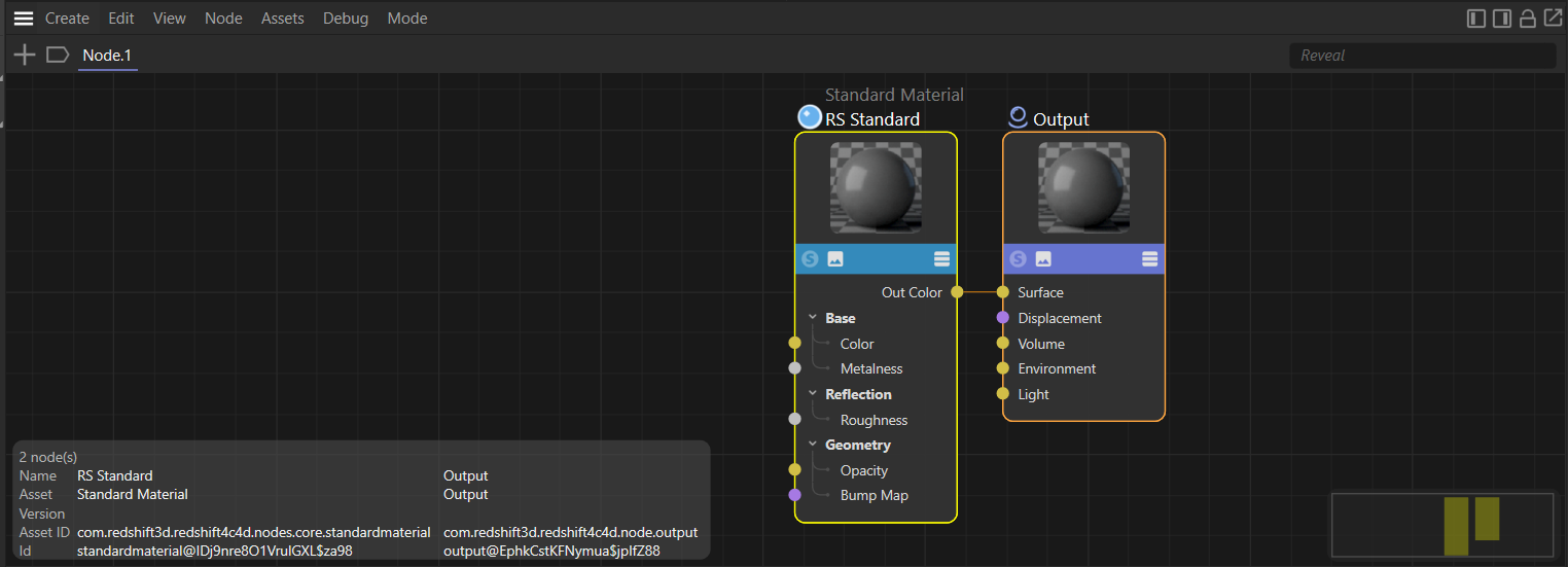

<p dir="auto">When you create a non-empty Redshift graph, you must identify nodes in it via their asset ID. A node in a graph is identified by two things, its node ID which is unique to the instance, and the asset ID which is the same for all nodes of the same type.</p>
<p dir="auto"><img src="https://developers.maxon.net/forum/assets/uploads/files/1695026735549-3d4206a0-ecaa-4eca-8fd4-f880d943fa42-image.png" alt="3d4206a0-ecaa-4eca-8fd4-f880d943fa42-image.png" class=" img-fluid img-markdown" /></p>
<p dir="auto"><em>Fig. I: The two IDs are displayed in the node editor info panel for the selected node. Make sure to have <code>Preferences\Node Editor\Ids</code> enabled to also see the node ID in addition to the asset ID.</em></p>
<p dir="auto">The <code>2023.1</code> example mentioned above makes use of asset IDs in this stretch of code to select the RS Material node contained in the (old) default graph:</p>

<p dir="auto">This also highlights the problem with it, as you are unable to distinguish two node instances of the same type in this manner. The default graph in the standard material system has predictable/persistent node IDs.</p>
<p dir="auto"><img src="https://developers.maxon.net/forum/assets/uploads/files/1695026312412-95e16d67-fd76-4f2e-aa25-5075d4064711-image.png" alt="95e16d67-fd76-4f2e-aa25-5075d4064711-image.png" class=" img-fluid img-markdown" /><br />
<em>Fig. II: The two nodes in the Standard Renderer default graph will always have the IDs <code>material</code>, and <code>bsdf</code>.</em></p>
<p dir="auto"><img src="https://developers.maxon.net/forum/assets/uploads/files/1695026435072-df209011-7ad7-4010-ba00-17061a3018a7-image.png" alt="df209011-7ad7-4010-ba00-17061a3018a7-image.png" class=" img-fluid img-markdown" /><br />
<em>Fig. III: The two nodes in the Redshift Renderer default material on the other hand will not have predictable IDs, as they are newly hashed for each graph.</em></p>
<p dir="auto">This forces you then to search the graph over asset IDs just as shown in the <code>2023.1</code> example.</p>
