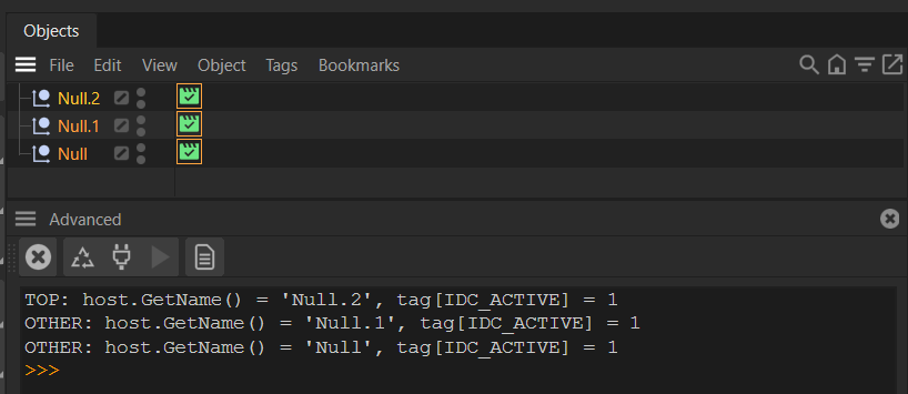

<p dir="auto">Which will print this when you add the tags:</p>
<p dir="auto"><img src="https://developers.maxon.net/forum/assets/uploads/files/1694702486106-baebed6a-fdc0-4d53-8214-1d6b2011cad8-image.png" alt="baebed6a-fdc0-4d53-8214-1d6b2011cad8-image.png" class=" img-fluid img-markdown" /></p>
<p dir="auto">So, the topmost tag is indeed inactive and the icon rendering is correct. The question is now: <em>'Why is that tag inactive because we initialize all tags as <code>node[IDC_ACTIVE] = IDC_ACTIVE_ON</code> ?'</em> The likely culprit is just a few lines above, as we toggle there the active state of our tag.</p>
