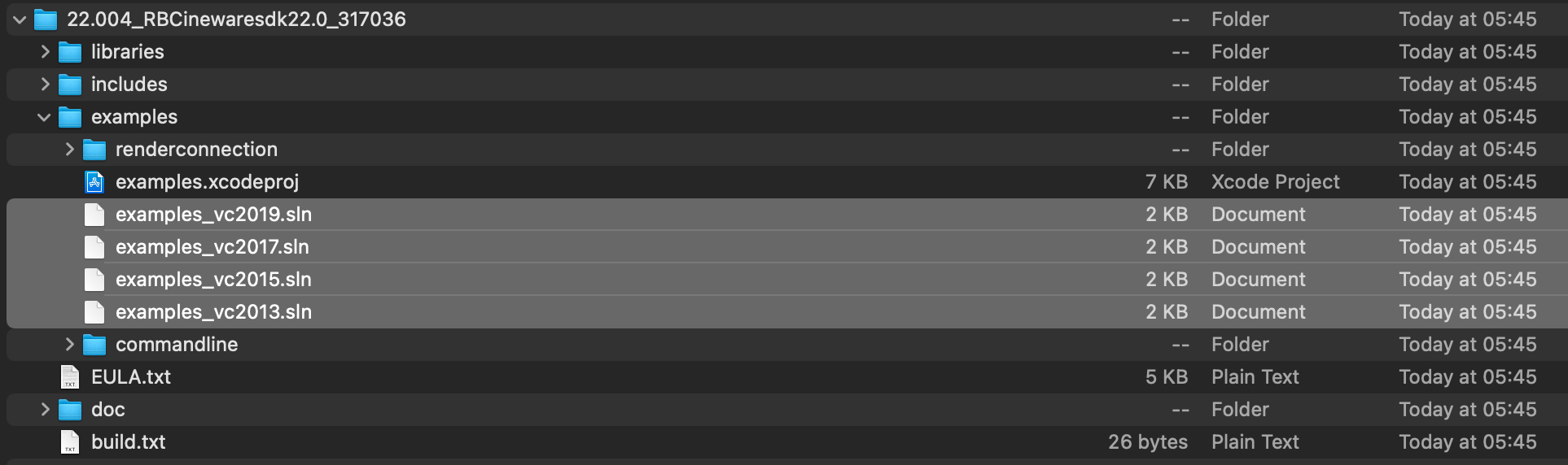

<p dir="auto">As you can see <a href="https://developers.maxon.net/docs/CinewareSDK/html/page_general_information.html" target="_blank" rel="noopener noreferrer nofollow ugc">here</a>, Visual Studio 2022 is not supported by the Cineware SDK. I am also not quite sure how you remark regarding <code>C++14</code> is to be understood. Are you using one of the solutions provided with the SDK?</p>
<p dir="auto"><img src="https://developers.maxon.net/forum/assets/uploads/files/1689242937881-5fcc280a-da0c-48b6-a3c5-6fa72e5713f2-image.png" alt="5fcc280a-da0c-48b6-a3c5-6fa72e5713f2-image.png" class=" img-fluid img-markdown" /></p>
<p dir="auto">I would have to ask you to use VS 2019 and our solutions. If the problem then still does persist, please share your non-working solution with us.</p>
