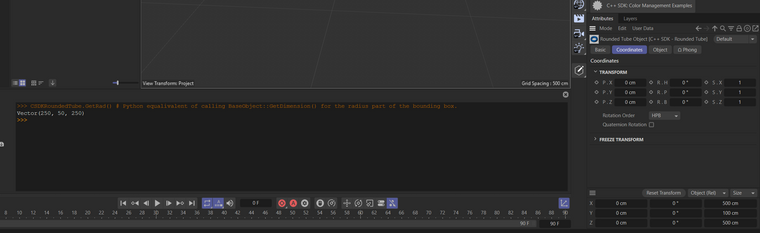

<p dir="auto">Thank you for reaching out to us. Unfortunately, your question is a bit ambiguous, especially regarding how you register your plugin and what you would consider to be <em>"to be completely ignored"</em>, and finally the code you have written.</p>
<p dir="auto">Our C++ <code>ObjectData</code> example plugin <a href="https://github.com/PluginCafe/cinema4d_cpp_sdk_extended/blob/master/plugins/cinema4dsdk/source/object/roundedtube.cpp" target="_blank" rel="noopener noreferrer nofollow ugc">Rounded Tube</a> does overwrite <code>::GetDimension</code> and it does what I would expect it to do.</p>
<ol>
<li><code>ObjectData::GetDimension</code> is called when <code>BaseObject::GetDimension</code> is invoked (or its Python counter parts <code>.GetMp()</code> and <code>.GetRad()</code>). The call chain from <code>BaseObject::GetDimension</code> goes through our core and <em>visits</em> during this also <code>ObjectData::GetDimension</code>. There are of course fallback methods in place which take over when <code>ObjectData::GetDimension</code> is not implemented, but I neither see any general conditions which would suppress the output from <code>ObjectData::GetDimension</code> nor is there a difference when I inspect the values.</li>
<li>The only central exit conditions are:<br />
a. The plugin interface is the null pointer.<br />
b. The plugin is <code>OBJECT_ISSPLINE</code>, then <code>SplineObject.GetDimension</code> will be called on the cache of the Spline object generator your plugin is implementing.<br />
c. Otherwise <code>ObjectData::GetDimension</code> will be called with the bounding box values which have been calculated so far.</li>
<li>Other events and entities are also calling this same chain, and from what I can see, they all work properly.</li>
</ol>
<p dir="auto">Calling <code>BaseObject::GetDimension</code> indirectly from Python, the returned value <code>250, 50, 250</code> lines up with the value <code>500, 100, 500</code> in the Coordinate Manager. Note that <code>GetDimension</code> asks for the <em>'radii'</em> of the bounding box, not its diameters. So, you must return half the value for each bounding box axis.</p>
<p dir="auto"><img src="https://developers.maxon.net/forum/assets/uploads/files/1668512625367-1a2c0e19-2a9e-4173-859f-ddb1a27a8d4b-image-resized.png" alt="1a2c0e19-2a9e-4173-859f-ddb1a27a8d4b-image.png" class=" img-fluid img-markdown" /></p>
<p dir="auto">And <code>RoundedTube::GetDimension</code> being called, setting these values, the break point is on the method scope exit, and shown are the returned values for <code>rad</code>:<br />
<img src="https://developers.maxon.net/forum/assets/uploads/files/1668512588598-ca66ebbf-712e-4db0-870e-4d840366c9cc-image.png" alt="ca66ebbf-712e-4db0-870e-4d840366c9cc-image.png" class=" img-fluid img-markdown" /></p>
<p dir="auto">Cheers,<br />
Ferdinand</p>
