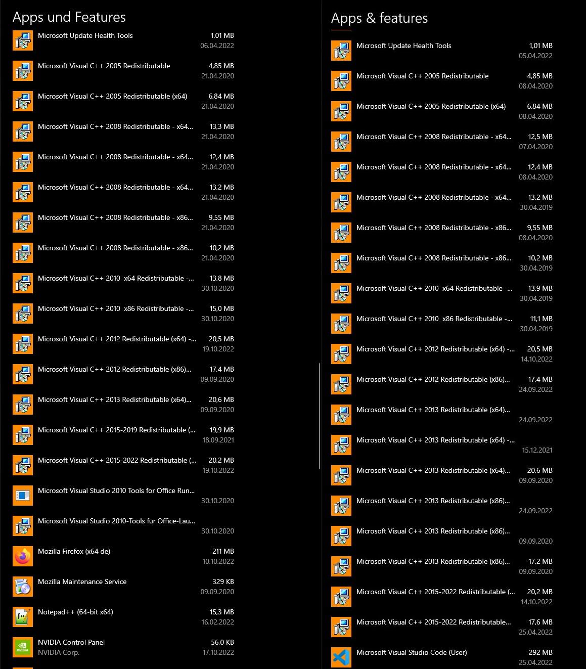

Left is the non-working OS.<br />
<img src="https://developers.maxon.net/forum/assets/uploads/files/1666176686035-redistcompare.jpg" alt="redistCompare.jpg" class=" img-fluid img-markdown" /></p>
<p dir="auto">Thanks a lot!</p>

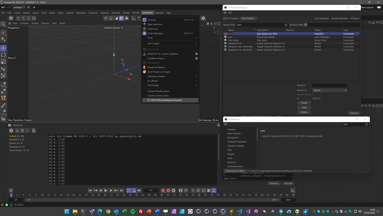

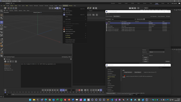

<p dir="auto">Thank you for your reply. So, I have tested your binaries under <code>2023.0.0</code>, <code>2023.0.1</code>, and <code>2023.1.0</code>. Guessing from your code listing, I assume that you are registering a <code>CommandData</code> and a <code>PrefsDialogObject</code> plugin hook. The plugin loads in all versions for me, see details below</p>
<p dir="auto"><code>2023.0.0</code> <img src="https://developers.maxon.net/forum/assets/uploads/files/1666187466674-solo_2023_0_0-resized.png" alt="solo_2023_0_0.png" class=" img-fluid img-markdown" /><br />
<code>2023.0.1</code><img src="https://developers.maxon.net/forum/assets/uploads/files/1666187501462-solo_2023_0_1-resized.png" alt="solo_2023_0_1.png" class=" img-fluid img-markdown" /><br />
I cannot show you a screenshot of <code>2023.1.0</code> for obvious reasons, but it loads there too.</p>
<ul>
<li>You say nothing is being printed to the console, which is odd, as your plugin has multiple <code>ApplicationOutput</code> calls. This is a strong indicator for your plugin not lying on the plugin search paths of the Cinema 4D where it is not loading, please check the plugins include folders in the Preferences dialog of Cinema 4D.</li>
<li>Something is going wrong (buttons are missing) with the Preferences plugin you seem to register in <code>2023.0.0</code>, but that is not too surprising, since you complied against <code>2023.0.1</code> and plugins are not downwards compatible.</li>
<li>In all versions your plugin does not appear in the "Extensions" menu unless I am blind. Since you are not showing the actual registration calls, only wrapper functions for them, I can only speculate here. You could for example be intentionally using <code>PLUGINFLAG_HIDE</code> as you do not want the plugin to show up.</li>
<li>Your copyright remark is printed to the console in all versions.</li>
<li>The plugin loads for me in all versions of <code>2023</code>, with the detail of the mentioned and to be expected problems in <code>2023.0.0</code>.</li>
</ul>
<p dir="auto">So, bottom line: I would check here if you indeed included the plugin folder. When you are looking for the plugin in the <em>Extensions</em> menu, I would check your actual registration for the flags you are passing. Remove <code>PLUGINFLAG_HIDE</code> when you are passing it.</p>
<p dir="auto">When all this does not help, we will need a bit more code, especially the defintion of your <code>RegisterSOLO()</code> and <code>RegisterSoloPrefs()</code> would be relevant.</p>

<p dir="auto">Thank you for reaching out to us. It is not so easy to answer your question in the current form. I am going to itemize a few things in bullet points to indicate what information is missing and where potential problems could lie. When the bullet points do not help you, you should provide the missing information.</p>
<h4>General Information about ABI and Dependencies</h4>
<ul>
<li>For which exact SDK have you built your plugin? <code>2023.0.0</code> I assume? Note that our SDK is never downwards compatible. So, when you happen to have beta access, and have built for <code>2023.1.0</code>, such plugin will not run under <code>2023.0.0</code>. But since we keep the ABI stable for roughly a year, a plugin compiled for <code>2023.0.0</code> will run under <code>2023.1.0</code>. The ABI version for 2023 is <code>2022901</code>, you can find out more about ABI versioning on the <a href="https://developers.maxon.net/docs/cpp/2023_2/page_maxonapi_plugin_dev.html#page_maxonapi_plugin_dev_environment" target="_blank" rel="noopener noreferrer nofollow ugc">Plugin Development</a> page.</li>
<li>The "Apps and Features" list should not play any role here, as Cinema 4D does bring all its dependencies on installation, and when Cinema 4D starts, you have everything what is necessary to load plugins. The dependencies of plugins are the SDK, more precisely the <code>frameworks</code> folder in it, against which you compile; it must match the ABI version of the Cinema 4D you want to run the plugin under. But since you likely built for <code>2023.0.0</code> and want to run under <code>2023.0.0</code>, ABI does not play a role here.</li>
