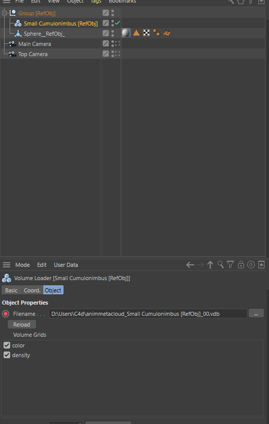

I have a few issue with the Volume loader.<br />
Context: when loading a multi-grid vdb file in c4d (R23 for instance), a Volume loader is created with a list of the internal grids.<br />
So, for my export I tried to do the same thing ( if I split the grids on one per file and create  volume objects, it works perfectly).<br />
First issue: the cineware Sdk does not contains the define/param for Ovolumeloader ( #define Ovolumeloader 1039866 is findable on the internet and mentionned in the documentation ).<br />
( that is not really an issue but seems to be a forgotten file)</p>
<p dir="auto">Second issue : when I save my files with a relative path: the loading of the lit of internal grid seems to be broken.<br />
As an exemple: I read the file with the commandline tool  after the export from VUE and after saving it in C4d:</p>

<p dir="auto">As we can see, the param 6008 ( the listview) is modified at the load of the relative path file.</p>
<p dir="auto">here find attached screenshots of what happens when I load the files in C4d and the save file ( with the _00.vdb file ( assume that the _XX.vdb are identical from _00.vdb file<img src="https://developers.maxon.net/forum/assets/uploads/files/1631807074388-absolute.png" alt="Absolute.PNG" class=" img-fluid img-markdown" /> )[0_1631807093381_animmetacloud_Small Cumulonimbus [RefObj]_00.vdb](Uploading 100%)</p>

it seems that the length of the folder where I save the c4d file have an incidence on whether the volumeloader work correctly or not  ( C4d R23).<br />
if I save the file to E:\data\tests\export\USD, the volume loader does not work, If I save the same thing to E:\USD, it works.<br />
here are the files ( I renamed the files afterwards, tell me if you find a difference )<br />
<a href="https://developers.maxon.net/forum/assets/uploads/files/1648560228177-untitled2_longfolder.c4d" target="_blank" rel="noopener noreferrer nofollow ugc">Untitled2_longfolder.c4d</a><br />
<a href="https://developers.maxon.net/forum/assets/uploads/files/1648560353316-untitled2_shortfolder.c4d" target="_blank" rel="noopener noreferrer nofollow ugc">Untitled2_shortfolder.c4d</a> <a href="https://developers.maxon.net/forum/assets/uploads/files/1648560357208-untitled2_dense-stratus.vdb" target="_blank" rel="noopener noreferrer nofollow ugc">Untitled2_Dense Stratus.vdb</a> <a href="https://developers.maxon.net/forum/assets/uploads/files/1648560356206-untitled2_cumulus.vdb" target="_blank" rel="noopener noreferrer nofollow ugc">Untitled2_Cumulus.vdb</a><br />
the files' reference are relative so they should load fine. ( at least in a short folder)</p>
