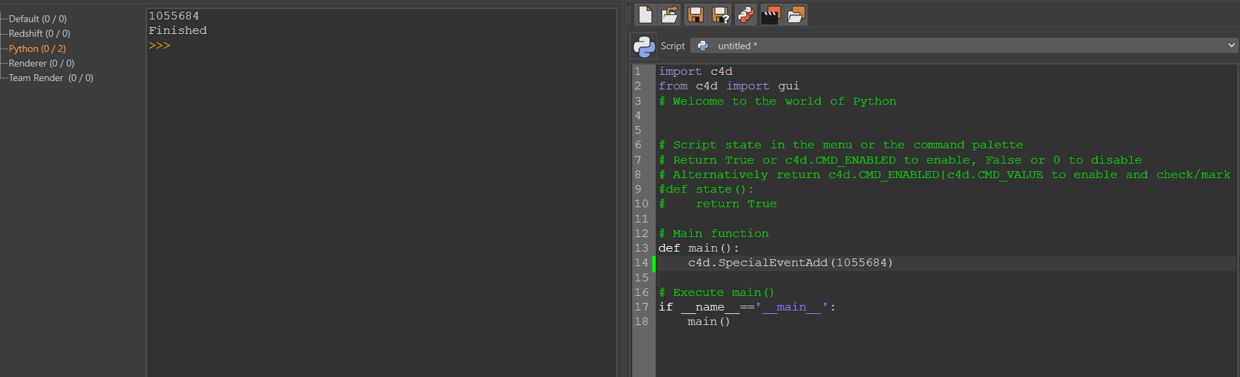

<p dir="auto">I just tried it too on R21.207 and it does not freeze for me either (I just added the message id as a print out, not knowing there was already that "finished" statement).</p>
<p dir="auto"><img src="https://developers.maxon.net/forum/assets/uploads/files/1610715028441-93d7cbc5-136f-4a1f-bdf5-cfae9d61b757-image.png" alt="93d7cbc5-136f-4a1f-bdf5-cfae9d61b757-image.png" class=" img-fluid img-markdown" /></p>
<p dir="auto">One thing you could do is to try to remove other plugins or scripts that are loaded by your Cinema 4D R21 installation, to make sure sure none of them is interfering with the plugin. When you have done this, you could also test, if opening a popup dialog in general, so something like this in the script manager,</p>

<p dir="auto">So on which os version? on which exact version of R21 are you (you can check in the about form)?</p>
<p dir="auto">In which context and how often are you calling SpecianEventAdd?<br />
Cheers,<br />
Maxime.</p>
